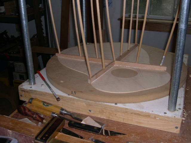

Top bracing going on (you've seen the rosette):

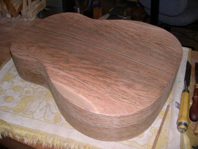

Next, a shot of the back glued to the sides:

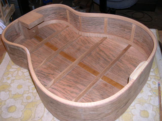

And, looking inside, before clean-up:

Purdy! Lookin mighty fine Steve.
It's nice to see your guitars from the inside -- oot.
PostPosted: Tue May 08, 2007 3:29 pm
That looks really good, Steve.  Nice clean work, and beautiful wood. Keep us updated.

    Real Nice!
That wood looks almost as good unfinished as finished.

Is it my old eyes or did you use regular kerfing for the back and reverse kerfing for the top?

Looks good to me bro. Did you run out of regular kerfing or do you just like to mix your kerfing styles. I am with you on the regular kerfing looking better so put it where it will catch the eye. The reversed kerfing on the top will support wide purfling better. IMHO.
                             Red
Good eye, Red!  I was going to ask that question, but chickened out.

Hesh, you are correct, that ain't spruce, it's Hond. mahogany.
Red, bro and Waddy, the upper is reverse kerfed, and the lower is the triangular. It's like KBE said, I just like the look of the triangular, so it's used where it's seen--on the back. And the order in which I put together the box, it benefits from having the reversed (stiffer) linings on the top.

I'm a little surprised no one took me to task over the glue squeeze-out on the top bracing pic.
What a kind bunch!

Tell us you did clean up the glue?

Mine looks pretty much like that too when it's first glued on so I assume you'll clean it up.

Hey what is that back reinforcement strip? My guess is mahogany with a little finish of some kind, but it could be narra or really just painted OSB
KBE
PostPosted: Fri May 11, 2007 4:25 am
Painted OSB?
Dang! Why didn't I think of that?
Actually, it's a scrap of old linoleum, pulled off the floor.
Either that or some mahogany that's got some FP on it.
